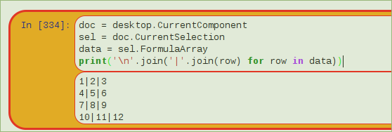

in python wäre das schlicht:
doc = desktop.CurrentComponent
sel = doc.CurrentSelection
data = sel.FormulaArray
print('\n'.join('|'.join(row) for row in data))
